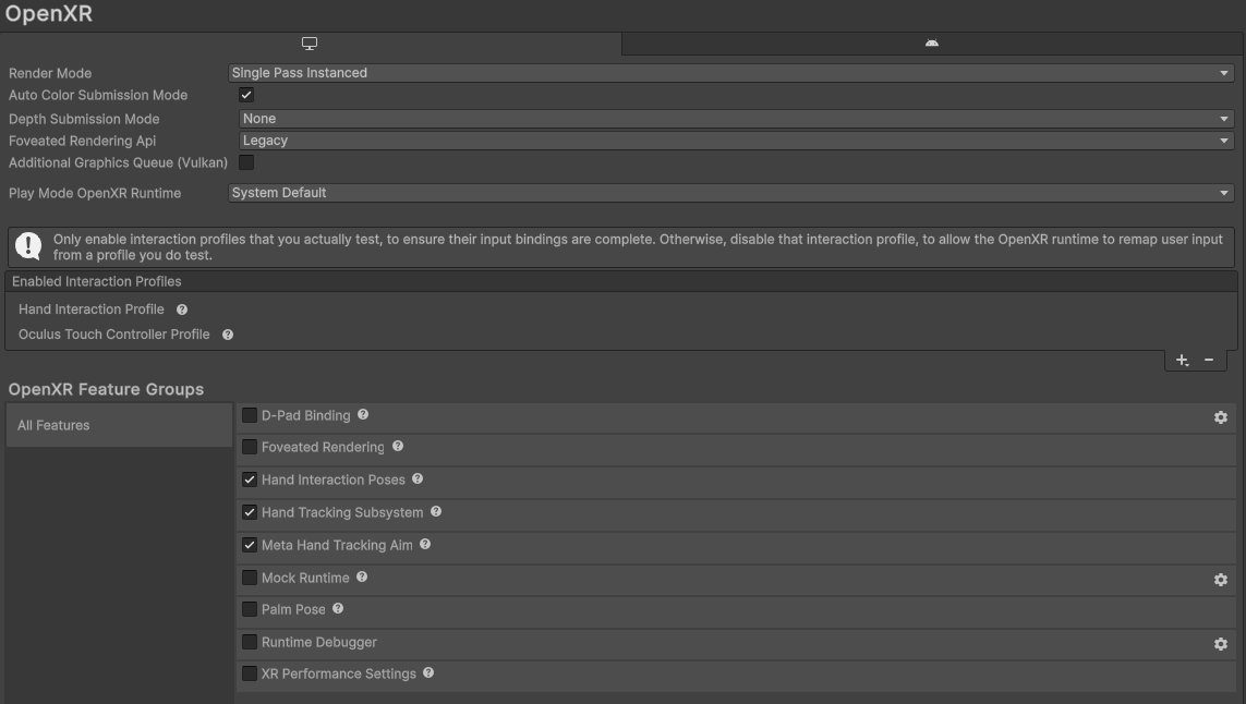

    For Hand Tracking to work in a Unity build (and of course the Portal Hopper is a Unity build) you need to register as a developer at Oculus/Meta. We are using OpenXR with the hand tracking drivers. You can build your Unity project to test and verify that hand tracking is working in your build.
