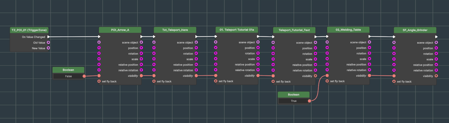

This is the node setup for the “Teleport_Here” and “Welding_Table” objects.
When I disconnect the execute connection from TZ_POI_01(TriggerZone) to POI_Arrow_A this weird behaviour stops. The nodes appear to be executed in the World Builder without entering the play mode in the Hopper. Is this supposed to happen?
Also, how can I detect when the Player has entered the TriggerZone?AnonymousMarch 4, 2025 at 12:00 pm #865Hey Boris,
thanks for sharing your node logics, that was very helpful.
The On Value Changed callbacks where indeed evaluated in the World Builder. I fixed the bug and it will be included into the next update.Jason
