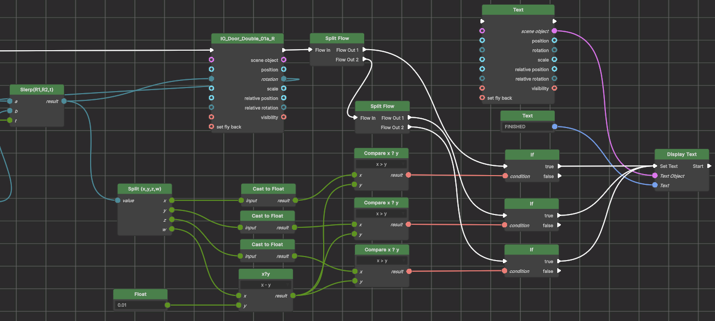

I am trying to create a “Split Flow” node that can trigger multiple nodes at the same time but I am having problems.
I’ve tried it like this, but the second output doesn’t execute.

I don’t believe the system was intended to activate multiple flow outputs at the same time. Is there any way to bypass this and make a Split Flow node that can activate multiple nodes at the same time?

May 27, 2025 at 5:03 pm #1633Actually, the second method should work RunFlowOutput(m_FlowOutput1) …
What are your error messages?
However, why not create a task node with 2 (3, in your example) tasks? At the end you just call “Next Task” and you get almost the same result, except that the second flow is executed 1 frame later.
May 28, 2025 at 10:15 am #1643I haven’t thought about using tasks, I’ll try that!
Maybe we can set up a meeting next week so I can show you the errors I get when using multiple flow outputs at the same time with RunFlowOutput(m_FlowOutput2).June 4, 2025 at 4:34 pm #1660I tried using multiple flow outputs in the way you are trying to use it and also got errors. It seems that at runtime, you (currently?) cannot call RunFlowOutput(). However, you might be able to call theNextNodesInput = FindInput(m_FlowOutput1.InputReference) if the flow output has a vaild reference (HasValidReference(m_FlowOutput1) is true if that output is connected to something)
Then you “manually” call the inputs Run action as in theNextNodesInput.Run(); I think this should work.
