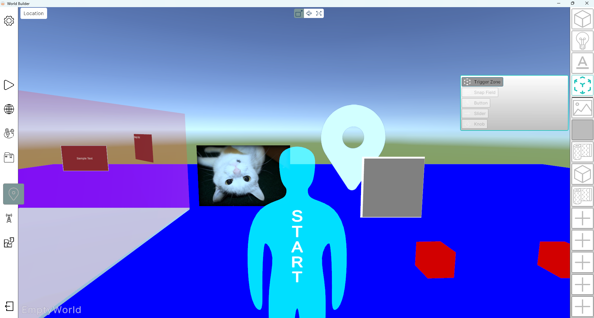

Is there a way to create interactive buttons that can be used in the logic editor (e.g., a button triggering specific actions)?
We see there is a grab system on objects, but we cannot get the “grab” event in the Logic Editor (would be a nice way to do simple interaction based logic).
I am currently working on a manual entry in the “How To” section to describe what you are looking for. In Short, you create a signal for the button. To trigger something, you connect something to that trigger.
For on/off behavior of a button (toggle switch), you need to drag the button signal into the Logic Editor and use its flow output and value to implement that. I’ll let you know when I’m finished with my “How To Build a Light Switch with an Interactive Button” tutorial.
