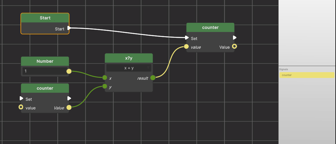

March 31, 2025 at 3:50 pm #1415
This should do it. Replace “Start” with the flow when you wish to increment the score.

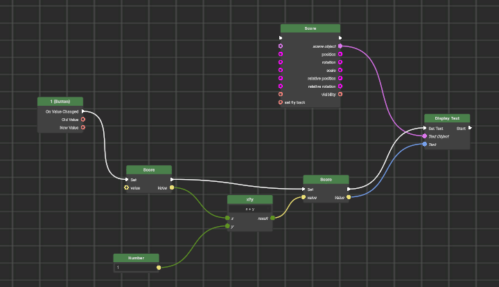

AnonymousApril 1, 2025 at 7:26 pm #1422Unfortunately, what you suggested is what I tried at the beginning, but the result, for some reason, is 2. To get 1, I have to do the following:
If I do this the first time it is fine, but for action that occurs later on, this resets the score to 0, so the result is always 1. In the case I do here as you suggested, I get 3 instead of 2. Why is this happening?
April 2, 2025 at 3:49 pm #1429Like I said in the tutorial, the solution is to only respond to button down, but in the logic above you increment on every change (button down and up), so the counter counts 2 each button press. To avoid that, add an if node with the New Value output of your button signal as the condition. Then only increment on the true output of the if node.
