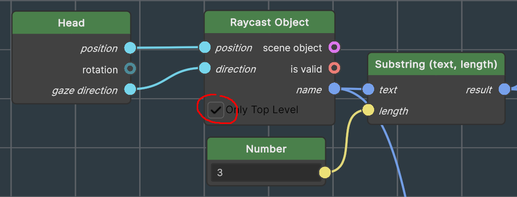

The Raycast Object Node ray casts only the top parent object, regardless of the state of the “Only Top Level” checker.
This is causing us huge problems because, without gaze data, our adaptive learning algorithm doesn’t work.
I hope this can be fixed in the next update. 🙏
I found the bug. The fix will come in the next Release (most likely Monday, 30th of June)
