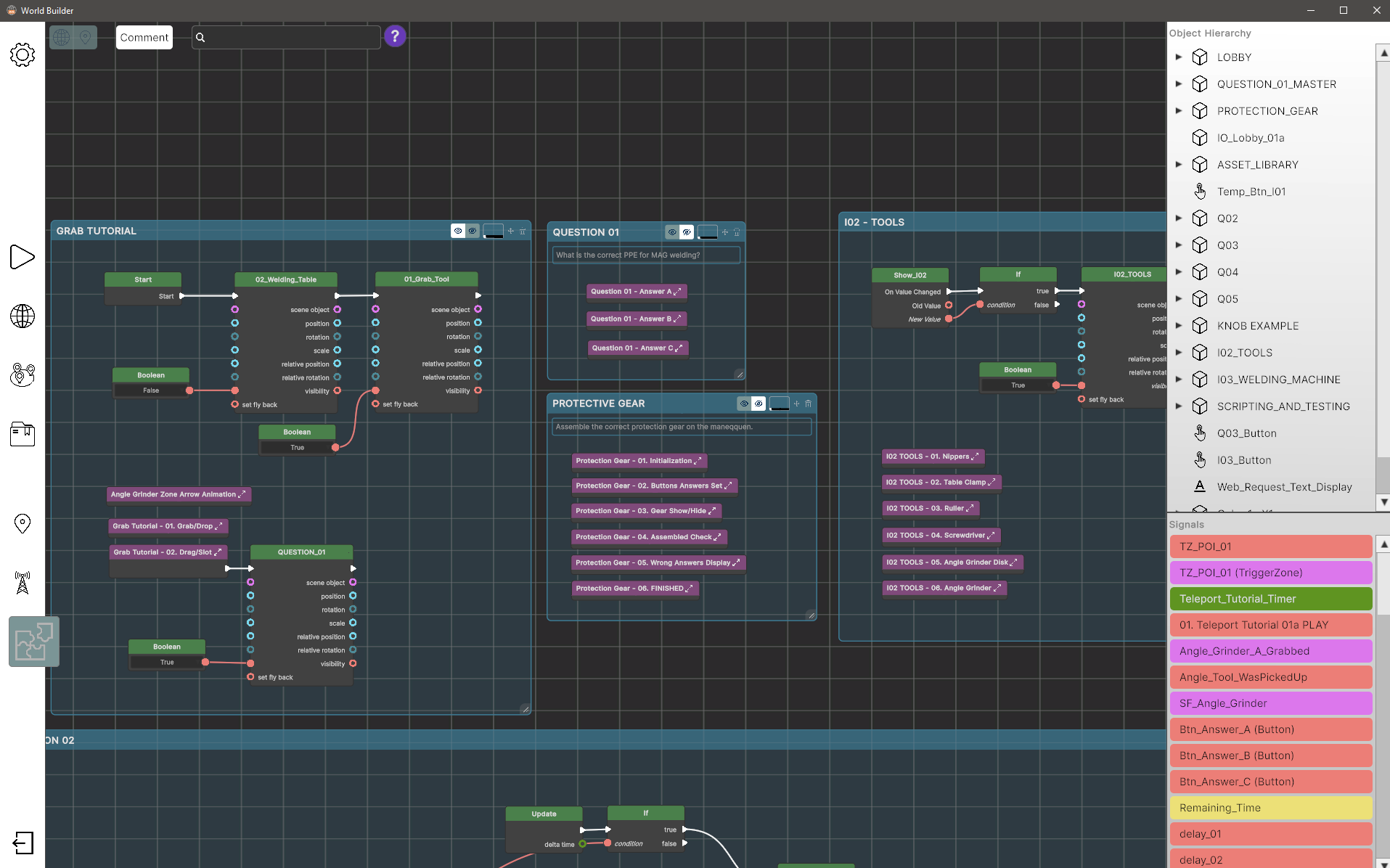

May 21, 2025 at 12:30 pm #1587I just want to add to this conversation that I’ve used the Group feature in the node editor to group many different functionalities and the performance of the node editor improved dramatically. I would suggest to use the logic editor normally when creating and testing new functionalities and then, once satisfied, grouping them inside a single node.
Just select all the nodes you would like to group, press the right mouse button, type “group” in the search window, and choose Group node. This will group all the selected nodes into a single Group node.
Many nodes can be grouped and organized this way. Enter the group by pressing the arrow buttons in the group node’s right side to edit and rename the node group. Use Node Connector nodes to make inputs and outputs to the group node.
May 21, 2025 at 12:31 pm #1588In the image below many different functionalities have been grouped. This is represented by the purple nodes with longer, descriptive names.
Node groups can be copied and pasted now, so you can reuse functionalities more easily.
