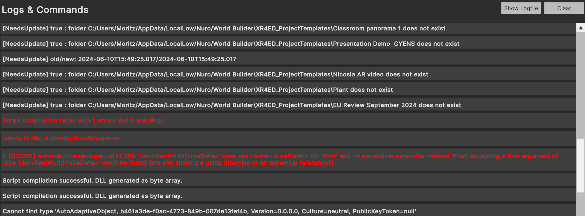

Hi
somehow it seems that I cant use System.Linq Extensions like (ToList(), First(), …)
I have the following usings in my code:
using System.Collections.Generic;
using System.Linq;
Any idea how to solve this?

April 3, 2025 at 4:08 pm #1434It turns out, the Runtime Compiler has a “White List”. Any usings of namespaces which are not in the White List will be purged. This is to ensure nobody calls dangerous commands which may harm the device/computer it’s running on. Think of the harm you could do with “using System.IO”…
Linq will be in the White List in our next release. We also plan to publish this list so everyone can check against it or request that we expand it.
