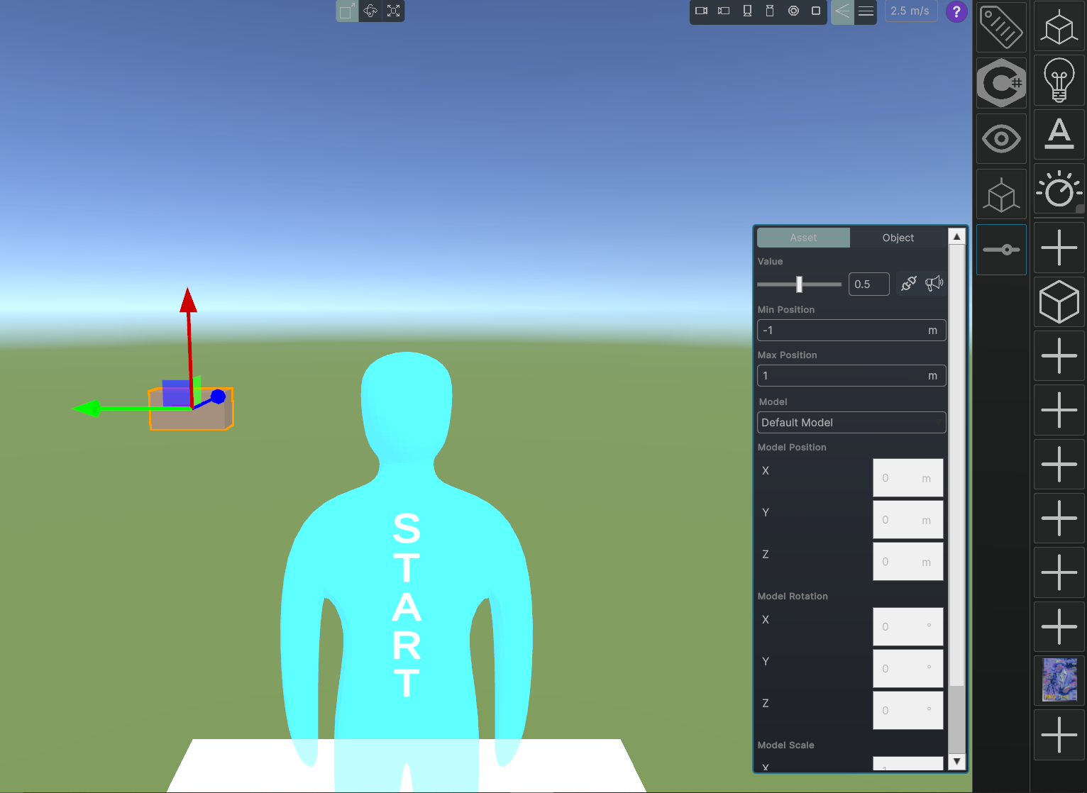

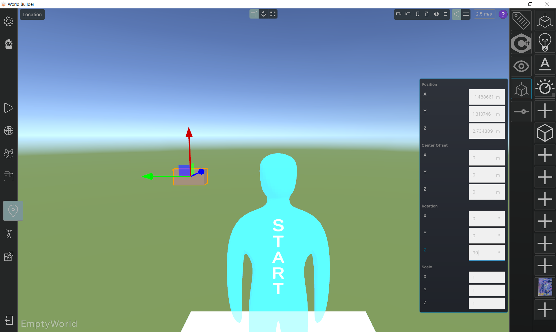

    To change the slider’s direction axis, you can rotate the slider object around the z-axis.Screenshot 2025-05-19 145953
    For other slider settings use the slider inspector:
    Screenshot 2025-05-19 150450
    You can connect signals that are setting or receiving the value of the slider with the buttons behind the value slider.

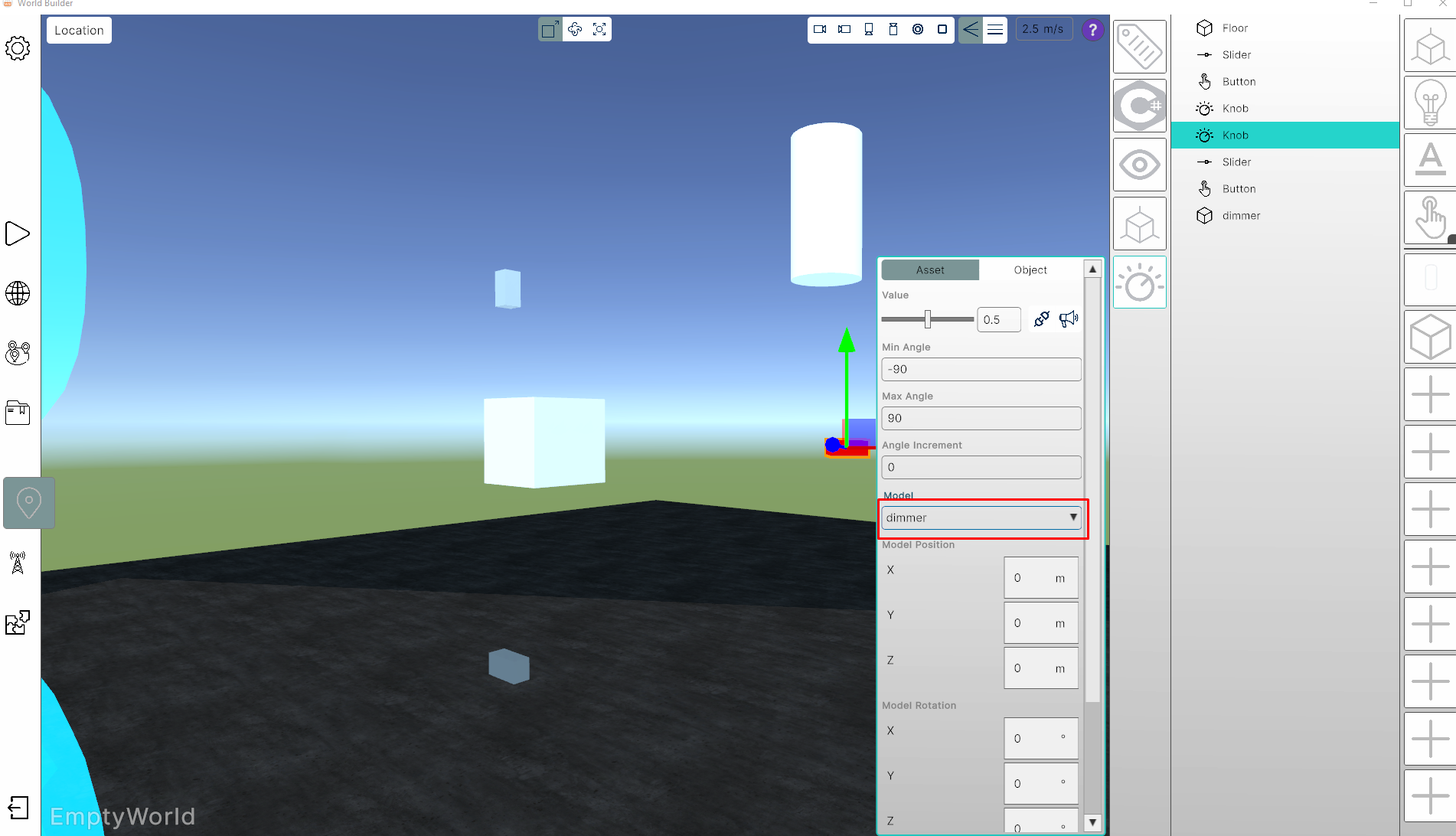

    I added some 3D models in .glb format (and later in .fbx as well), but when I select them from the dropdown list—as shown in the screenshot below—the mesh of the object doesn’t update to the selected model.
    dimmer
    Additionally, I’m unclear about the difference between the Asset and the Object in the knob/slider inspector window, as shown in the following screenshot.

    May 20, 2025 at 8:35 am #1576
    I double checked both Asset and Object mode of slider and knob. The object mode works, but the asset mode doesn’t work. This will be fixed asap.
    For your understanding:
    In Asset mode a new object will be placed at the position of the slider handle/turning knob.
    In Object mode an existing object in the location will become the slider handle/turning knob. You can test this when you change the value in the inspector. You should see the assigned object in the location moving.
    So for now, I would ask you to work with the object mode until the problem with the asset mode is fixed.

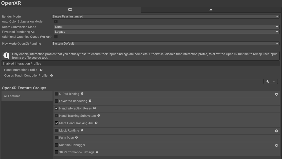

    For Hand Tracking to work in a Unity build (and of course the Portal Hopper is a Unity build) you need to register as a developer at Oculus/Meta. We are using OpenXR with the hand tracking drivers. You can build your Unity project to test and verify that hand tracking is working in your build.
    json2
