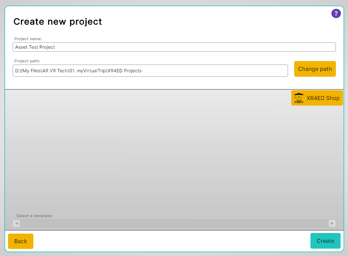

February 25, 2025 at 11:53 am #829
Can not create a new empty project in World Builder 2.0 because the Empty Template is missing. There’s no Empty Template on the marketplace either.

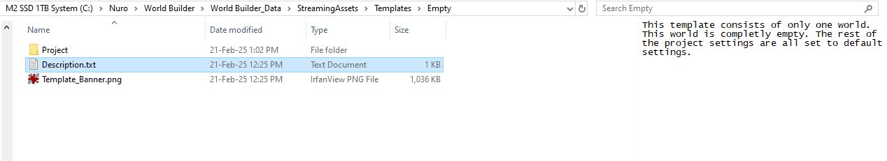

February 25, 2025 at 12:47 pm #830Does your WorldBuilder folder contain this path?
C:\Nuro\World Builder\World Builder_Data\StreamingAssets\Templates\Empty(if that’s where you installed it)
“Empty” is the standard Template to create a new project. It should contain a “Project” folder and “Descripton.txt” as well as “Template_Banner.png”.
If this is not the case, you may want to first uninstall the WB and then run the installer again.
Having the same problem.
Unfortunately I’ve checked for “Empty” folder and exists at the path and also reinstall WB2.0 but nothing changed .
The menu is not loading the purchased templates from “XR4ED shop” (ex Demo Classroom or Minimalistic Demo Class that we used on 6November2024 meeting).
Although previous projects based on those templates can open.

I’ve checked the folder with the Empty Template and all the files seem to be there.
Here’s the log file after trying to create a new project in the World Builder. I didn’t close the World Builder, I copied the content of the Player.log file with the builder still opened.

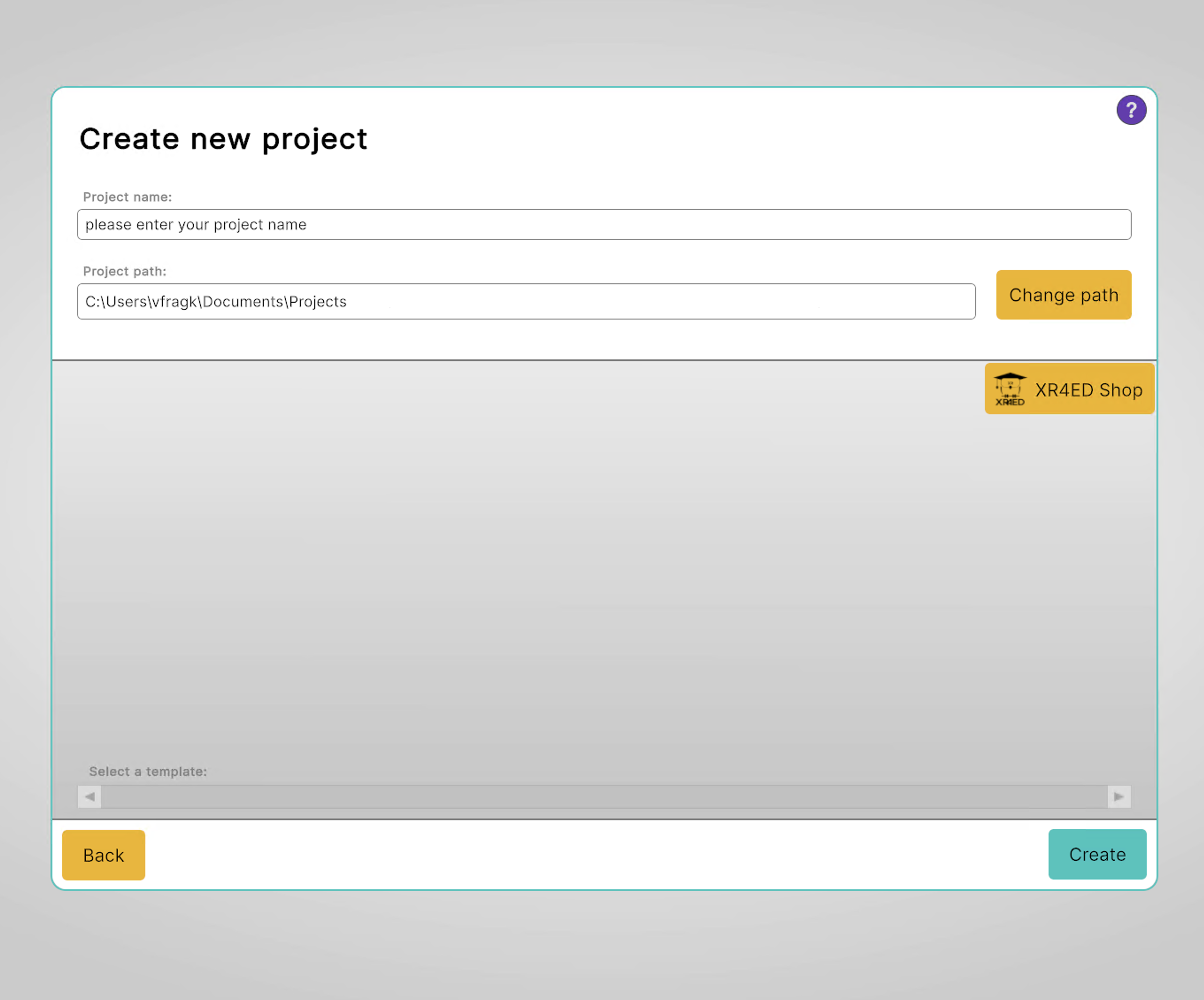

Here’s my log file when creating a new project with WB still opened
LOG file

C:\Users\vfragk\Documents\Projects\please enter your project name
NullReferenceException: Object reference not set to an instance of an object
at WorldBuilder.Core.ProjectManager.CreateProject (System.String projectName, System.String projectsDirectory, WorldBuilder.Core.ProjectTemplate template) [0x00025] in <6b223b282f62447a9a78ab3a7df089ca>:0
at WorldBuilder.UI.UICreateProjectScreenController+<>c__DisplayClass28_0.<Setup>b__3 () [0x0006c] in <6b223b282f62447a9a78ab3a7df089ca>:0
