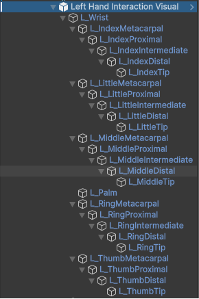

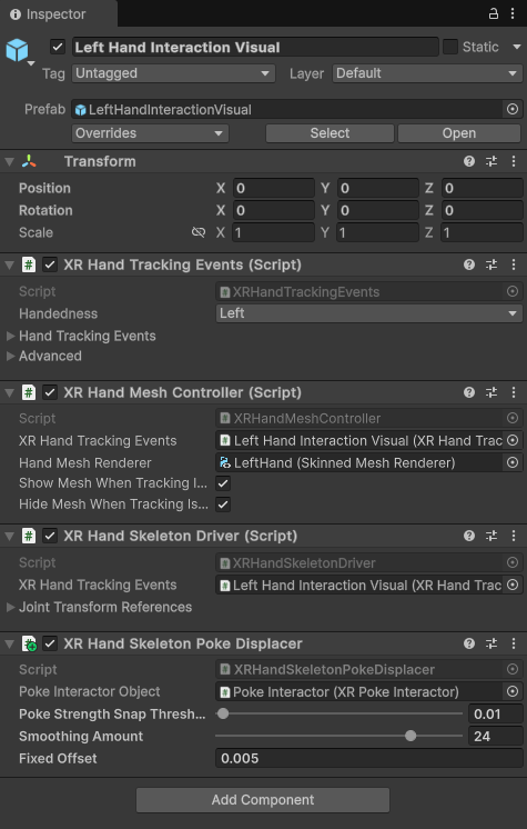

April 11, 2025 at 11:51 am #1455Hand tracking is now implemented in Release 0.2.2. You can download it now. The setup is as follows:
In the hierarchy, you’ll find
Hope this helps!

May 13, 2025 at 6:25 am #1539Hello Sametk13,
could you be a bit more specific as to how you would solve this algorithm in a Unity environment? I already pointed you to the hand hierarchy and the XR Hand Skeleton driver. What I need to know is how exactly you would recognize the gesture if you had all the position and orientation (rotation) information of both hand skeletons.
The
XRHandSkeletonDriveractually has a publicList<JointToTransformReference> jointTransformReferences;which you can use to detect all the information you may need. In your code you need to beusing UnityEngine.XR.Handsto have access to theXRHandSkeletonDriverCurrently, I am assuming you’ll create a specific Node which reads both hands and resolves the changes to the hands/fingers as a gesture which you can then output as a text which you can then display on a screen.The Node script is added to the World Builder who will compile it at runtime. The same (Node) script will also be running on the Portal Hopper’s side to actively interpret and display the detected hand signals. Correct?
