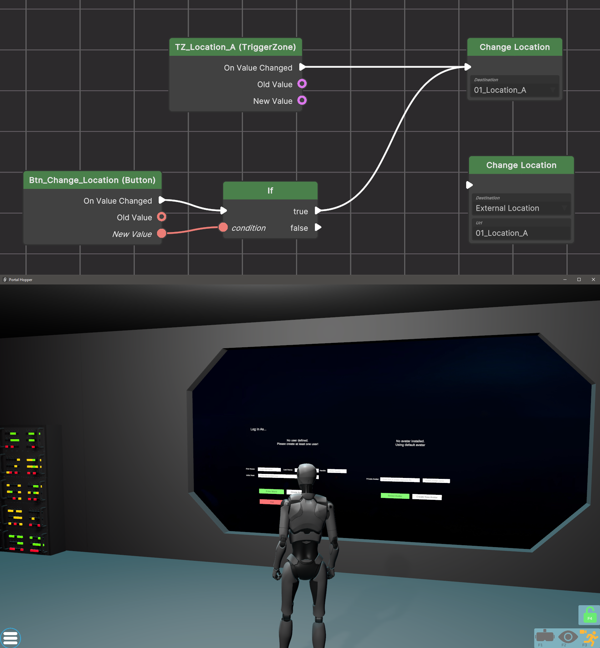

I am testing the “Change Location” node and I can’t make it switch to the desired location. Whatever I do the location is not changed to the desired one but to this default control room as shown in the image below:
I’ve tried using the TriggerZone to activate the Change Location node and I’ve tried picking the location from the dropdown as well as using the External Location and typing in the name of the location.
So I have two questions:
How to switch location to a specific location that was made in the project?
What is this default “Control room” being used for?
Change location
You need to put in the full path to the desired VRML file, e.g. https://vrweb.mydomain.com/2ndlocation.vrml
Control Room
The control Room is used to select and calibrate an Avatar (currently not important), to select a link to jump to, to define where the menu button should be placed on the hand (only in VR) and where the “finger” should be placed on the hand (only in VR).
