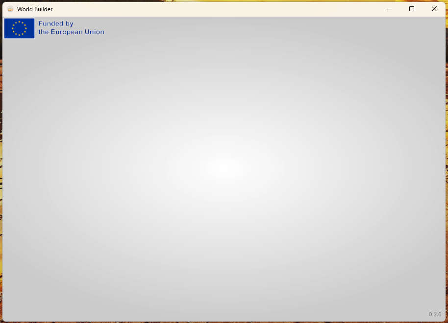

Hi, not sure what exactly happened but I can’t start the WorldBuilder anymore. It stucks before the Loading screen. After the update it was working the first time fine, but after inserting the sample dll nothing works anymore..
I tried the following:
- Removed the sample DLL again (of course :D)
- Reinstalled World Builder and Portal Hopper several times
- Restarted the PC serveral times
- Removed everything from the folder C:\Users\<user>\AppData\LocalLow\Nuro
- According to the Player.log there is a null ref
Player.log (last 4 lines):
Finished plugin [NuroWorldBuilderPlugins.Templates.TemplateExporter] setup with result: Succeeded
Finished plugin [NuroWorldBuilderPlugins.Templates.BuiltInProjectTemplateProvider] setup with result: Succeeded
Custom theme loaded: XR4EDTheme
NullReferenceException: Object reference not set to an instance of an object
at WorldBuilder.UI.UIProjectsScreenController.BindProjectsList (System.Collections.Generic.List`1[T] projects, System.Int32 selectedIndex) [0x00114] in <6b223b282f62447a9a78ab3a7df089ca>:0
at WorldBuilder.UI.UIProjectsScreenController.SetupOverview () [0x0037e] in <6b223b282f62447a9a78ab3a7df089ca>:0
at WorldBuilder.UI.UIProjectsScreenController+<Setup>d__45.MoveNext () [0x00040] in <6b223b282f62447a9a78ab3a7df089ca>:0
at UnityEngine.SetupCoroutine.InvokeMoveNext (System.Collections.IEnumerator enumerator, System.IntPtr returnValueAddress) [0x00026] in <861a7d13d11f4169ab7691fd56fe10cd>:0March 3, 2025 at 3:39 pm #859With first re-installing the old version (v0.1.36) and afterwards upgrading to v0.2.0 it works again.
